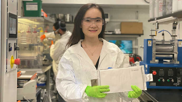

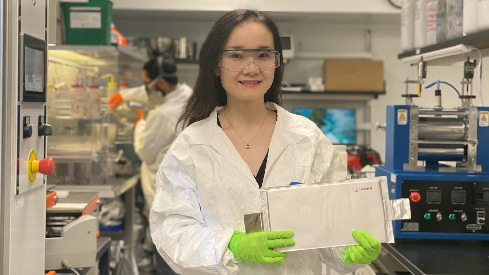

Both Mercedes-Benz and Stellantis announced joint development and investment deals with the U.S.-based solid-state battery startup Factorial Energy on November 30, but Mercedes-Benz said it’s aiming to integrate the technology into a “limited number of vehicles” as part of a “small series” within the next five years, while Stellantis had previously announced during its EV Day in July 2021 that it was targeting to introduce its first competitive solid-state battery technology by 2026, which likely doesn’t mean mass production. So again, it will be the end of this decade before we see significant volumes of solid-state battery powered vehicles from Mercedes-Benz and Stellantis.
Factorial, which is also working Hyundai Motor Group, prides itself on its proprietary FEST™ (Factorial Electrolyte System Technology), which leverages a proprietary solid electrolyte material that enables safe and reliable cell performance with high-voltage and high-capacity electrodes at room temperature. FEST™ is the first solid-state technology that has been scaled to 40Ah cells, works at room temperature, and can adopt a majority of existing cell manufacturing equipment, reducing the cost and complexity of changing to a different battery technology for OEMs.
