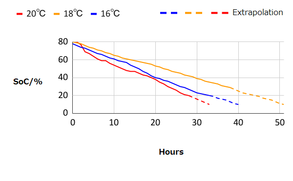

Battery consumption; 80% to 10% in 33 hours with 20°C interior settings
The battery state of charge (SoC) went down to 10% from 80% in 33 hours with A/C@20°C, 51 hours @18°C, and 40 hours @16°C, seat heating and an electric blanket.
The electricity consumption rate was less than we had expected, such that we had to stop the experiment (and return home) before reaching 10% SoC. Therefore, we extrapolate the data (dots) to simulate the experiment down to 10%.

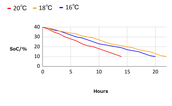

An estimate of SoC from 40% to 10%
Of course, most drivers cannot depend on their batteries starting with 80% or more SoC if they are unfortunate enough to become stranded in snow. However, our test suggests that just 40% SoC can last for 14 hours with 20°C, 22 hours with 18°C, 20 hours with 16°C, seat heating and an electric blanket. Therefore, the cars should provide a safe environment for the duration of a night, and 14 hours is usually enough time for emergency services to attend to the situation in Japan.

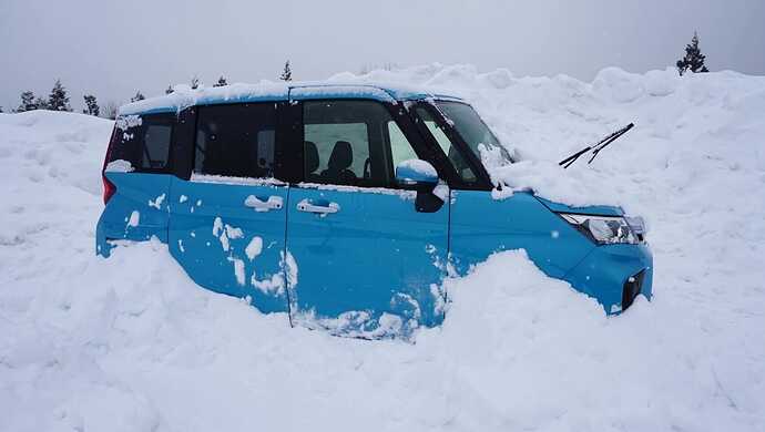

We buried a petrol car
A common concern for drivers stranded in petrol cars are the interior CO levels, which can increase if the car’s exhaust is blocked by snow. We measured these levels in a car that was buried to the top of the wheel well, and while using A/C with exterior air circulation enabled. A CO level measuring device left above the dashboard showed 322PPM in just 3 minutes: at this level, the average person will develop headaches and nausea within 2 hours. For a fair comparison, we performed the same test in a Model 3 similarly buried in snow, and unsurprisingly found no significant rise in CO levels.
To summarize our test, we found that being stranded in snow is an uncomfortable and exhausting experience regardless of whether you are an EV or petrol car. If snow continues to accumulate, you will have to frequently remove it from around an EV to avoid the doors getting stuck. However, the threat from CO poisoning is real, which means the zero emissions of the EV is a big advantage.
