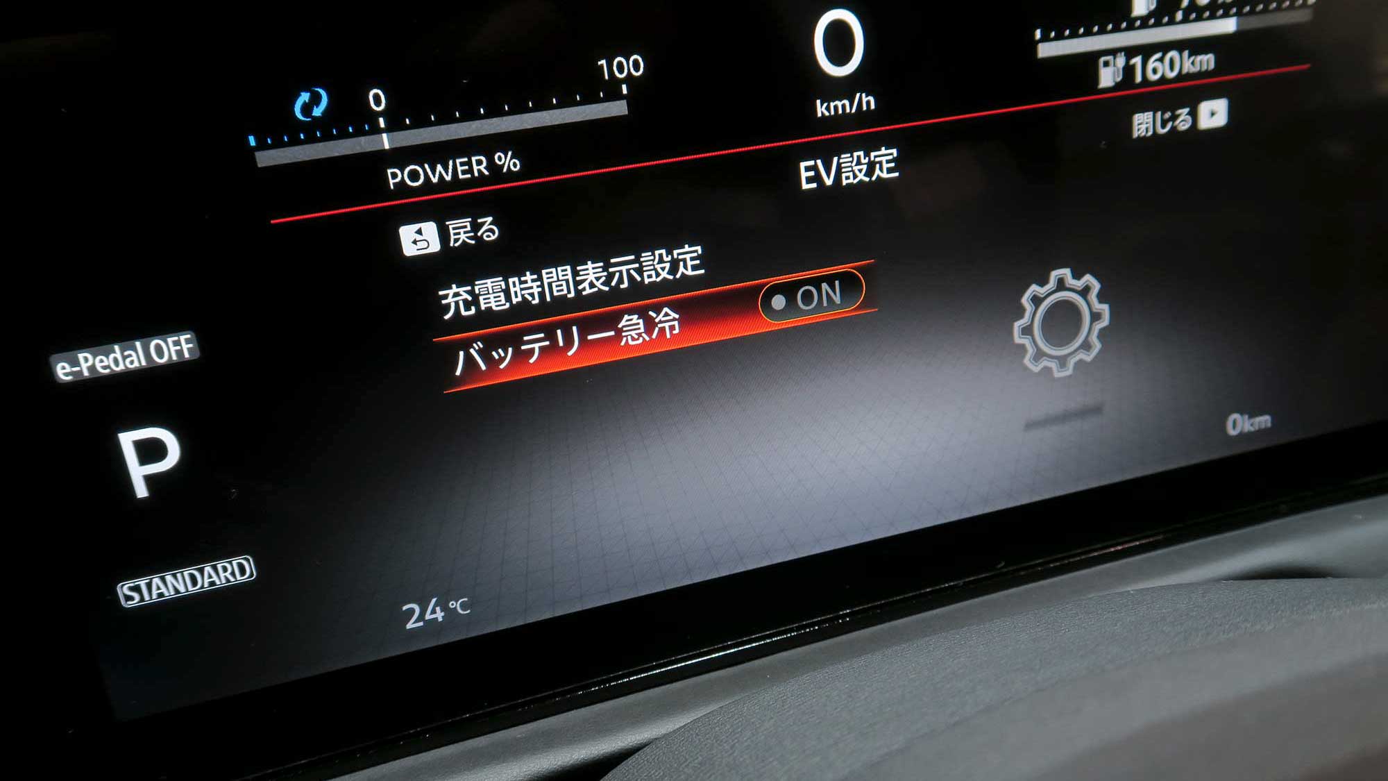

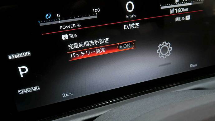

**I remember seeing a “fast battery cooling button” at an ARIYA exhibition at NISSAN’s global headquarters. **
Exhibition cars are usually unfinished versions, with a feature set that may differ from commercially released cars. The “Fast cooling battery” was an experimental feature, in which we compromised some noise inside the car in order to maximize cooling.
I did not find a thermometer for the batteries.
You checked the car in a lot of detail! I cannot confirm, but I expect final versions will have thermometers.

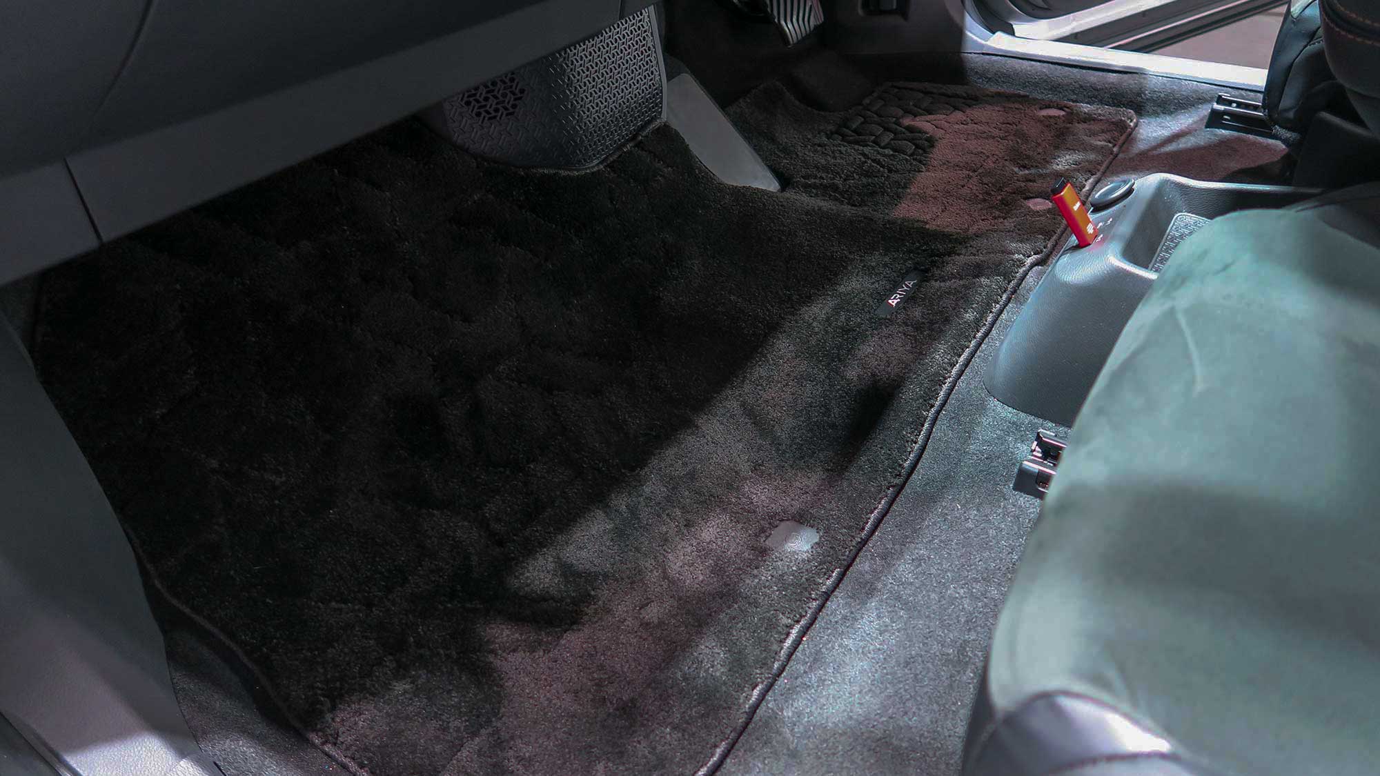

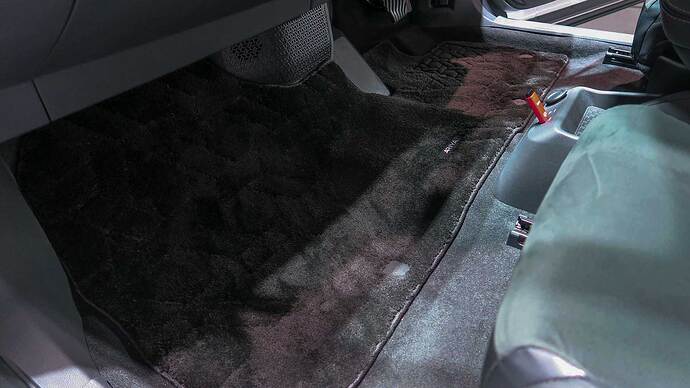

**I expected the floor to be flat, but the exhibition car had some raised sections in the middle. What is in there? **
That part contains equipment cables, such as the “ProPILOT 2.0” which requires power from a sub-battery.
