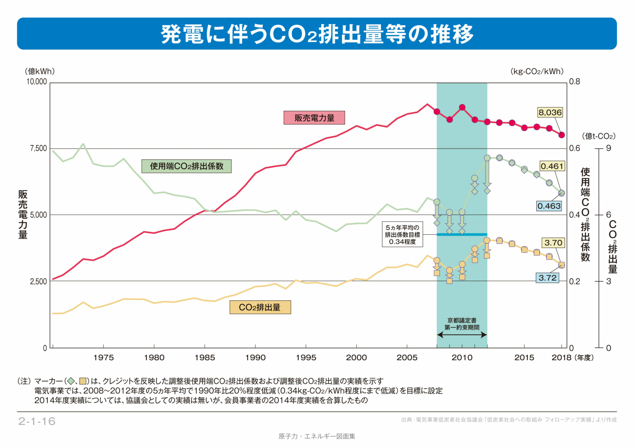

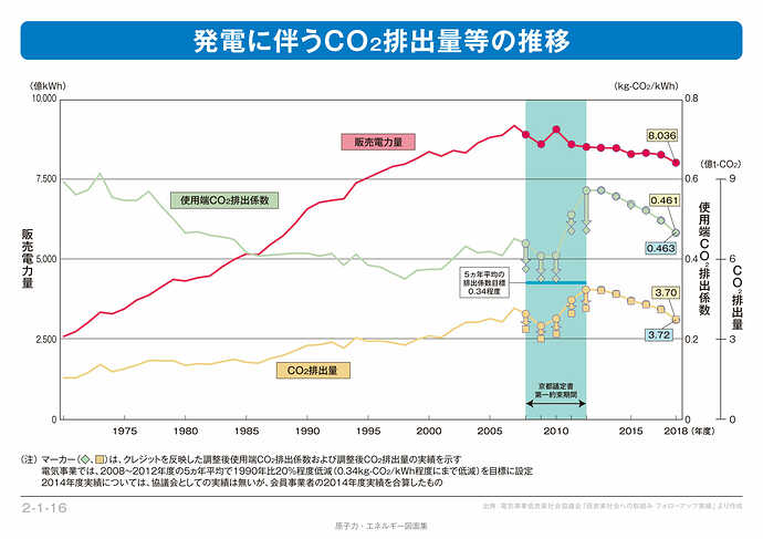

Further reductions in CO2 emissions from power generation are possible
Efforts to reduce the total emissions of EVs focus on either battery production or power generation. In general, the emissions from power productions have decreased in recent years. The graph above shows the CO2 emissions in Japan since 1970, including a turbulent period following the Fukushima Nuclear Power plant disaster in 2011, after which most nuclear power plants stopped activity. However, the total emissions have reduced from 552g/kWh to 463g/kWh, representing a 3.2% reduction per year on average.
Furthermore, market forces will continue to make power generation an increasingly economical solution. According to Carbon Tracker, ‘Renewables are outcompeting coal around the world and proposed coal investments risk becoming stranded assets which could lock in high-cost coal power for decades. The market is driving the low-carbon energy transition but governments aren’t listening. It makes economic sense for governments to cancel new coal projects immediately and progressively phase out existing plants.’
