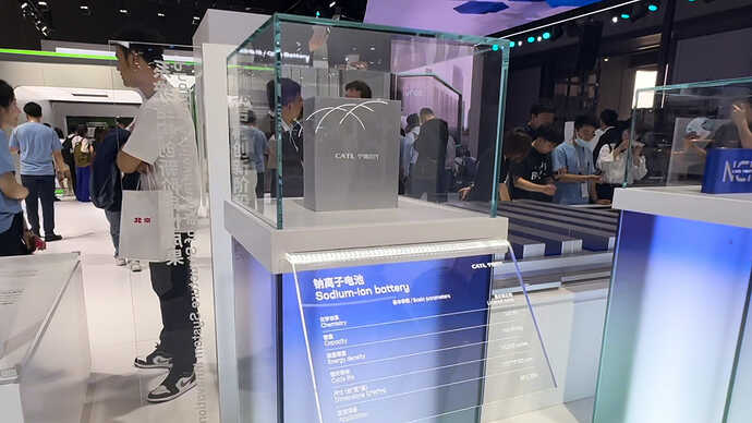

CATL displayed a AB pack as well an sodium-ion cell at the Shanghai Auto Show and I actually spent some time there learning from the engineers trying to get the lowdown on the current status of sodium-ion industrialization. The engineer I talked to did confirm SOP before the end of the year but stressed that it’ll take some time to cultivate the supply chain especially the upstream raw materials.
“The bottleneck remains to be these materials specific for sodium-ion batteries,” the engineer told me. “And that takes time for the supply chain to mature and production to ramp up.”
He also told me that initially production quantity for the iCAR vehicle with sodium-ion will not be that big, which again is affected by the supply chain. The sodium-ion cells will be integrated directly to a pack, utilizing CATL’s cell to pack or CTP technology which is then integrated into the chassis.
