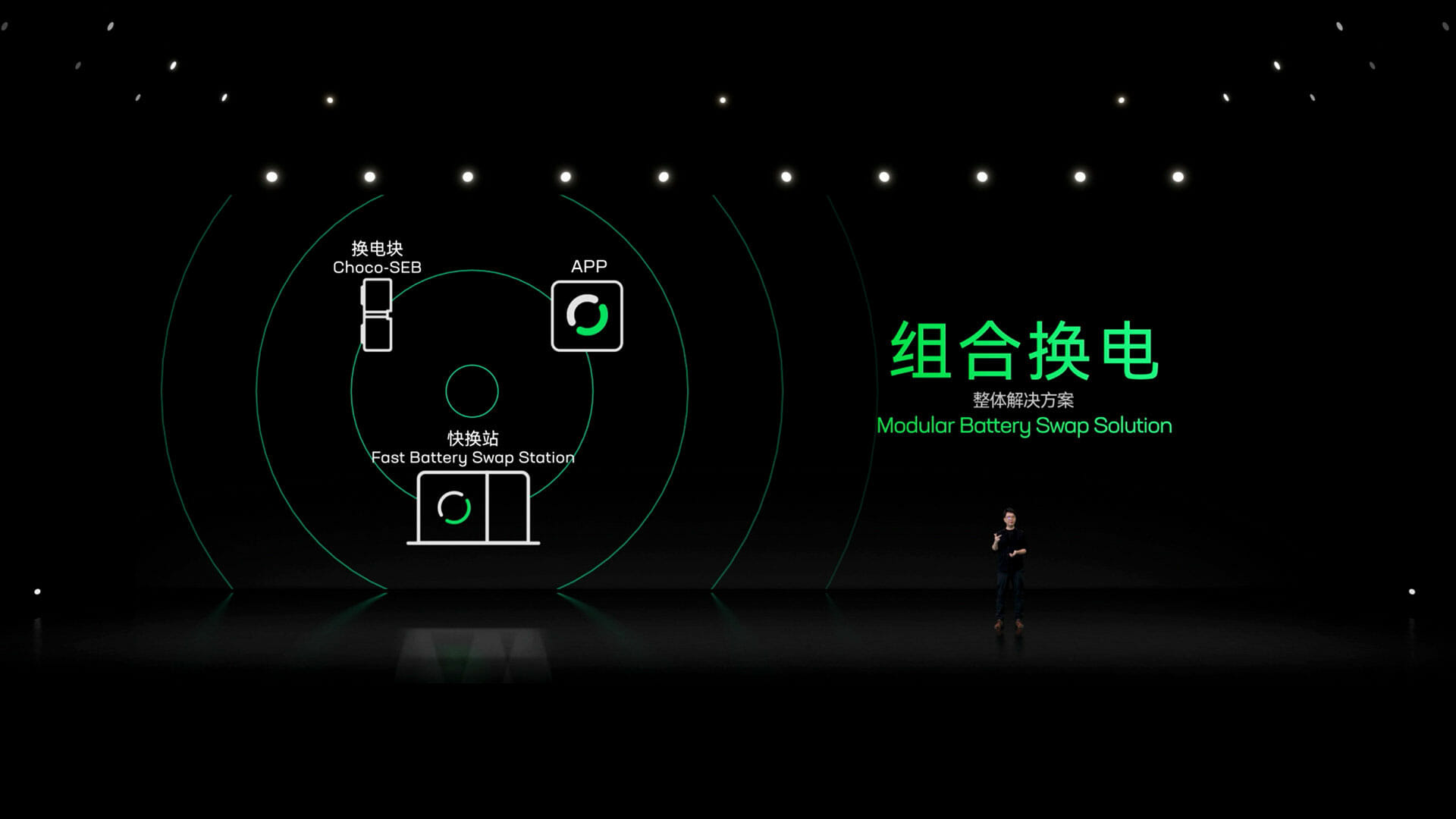

CATL’s wholly owned subsidiary, CAES (Contemporary Amperex Energy Service Technology Ltd.), will be the entity that will oversee the rollout of the EVOGO battery swap solution, which is comprised of the so-called Choco-SEBs (chocolate bar-like swappable electric blocks), swap stations and a dedicated EVOGO app. The solution will be launched initially in ten cities in China and the first EVOGO-compatible model will be the FAW Bestune NAT Modular Battery Swap edition with more from other automakers to be launched in the future, according to Chen Weifeng, general manager of CAES.

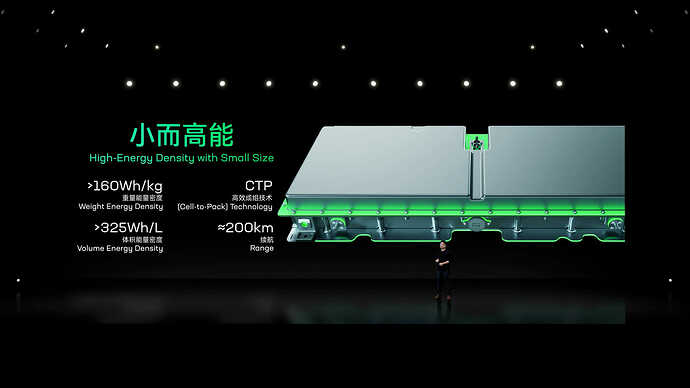

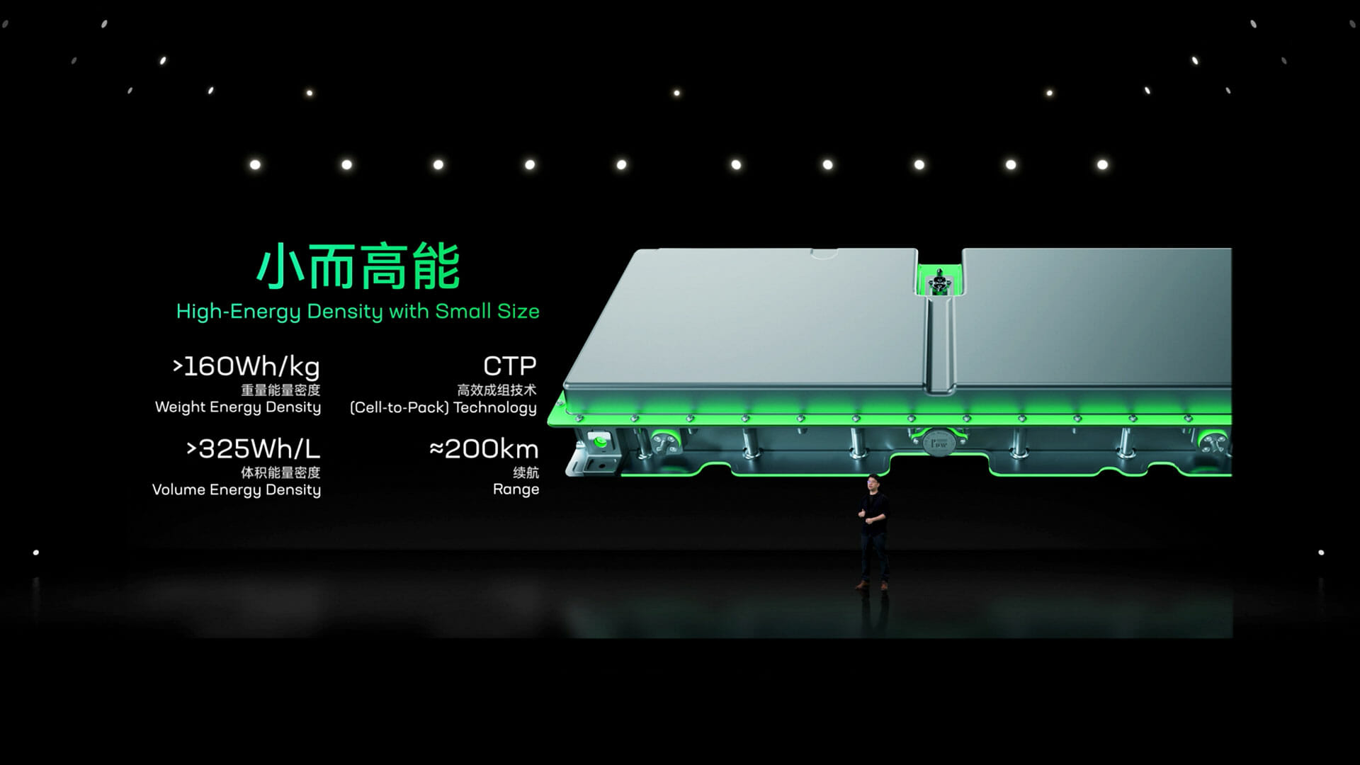

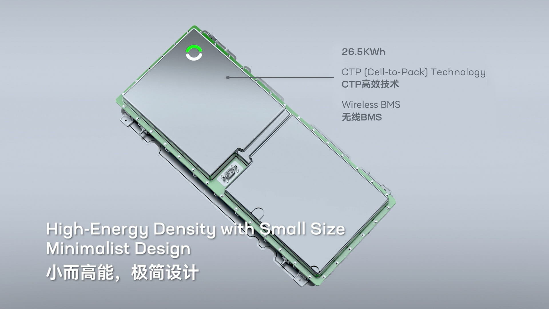

The Choco-SEB, so-named because of its chocolate bar-like design, is specially designed and developed for battery sharing and swapping, and boasts advantages of high-energy density with small size, flexible combination and minimalist design. Utilizing CATL’s latest CTP (cell-to- pack) technology, a 26.5-kWh single Choco-SEB can achieve a weight energy density of over 160 Wh/kg and a volume energy density of 325 Wh/L, enabling it to provide a driving range of 200 km.
CATL says the Choco-SEB is compatible with 80 percent of global BEV platform-based vehicle models available on the market, and all BEV platform-based models to be released in the next three years globally. Customers are free to take one to three blocks to meet different range requirements at swap stations. Furthermore, equipped with wireless BMS technology, the Choco-SEB does not have any parts on its exterior except the high-voltage positive and negative terminals, which significantly increases the reliability of plugs.

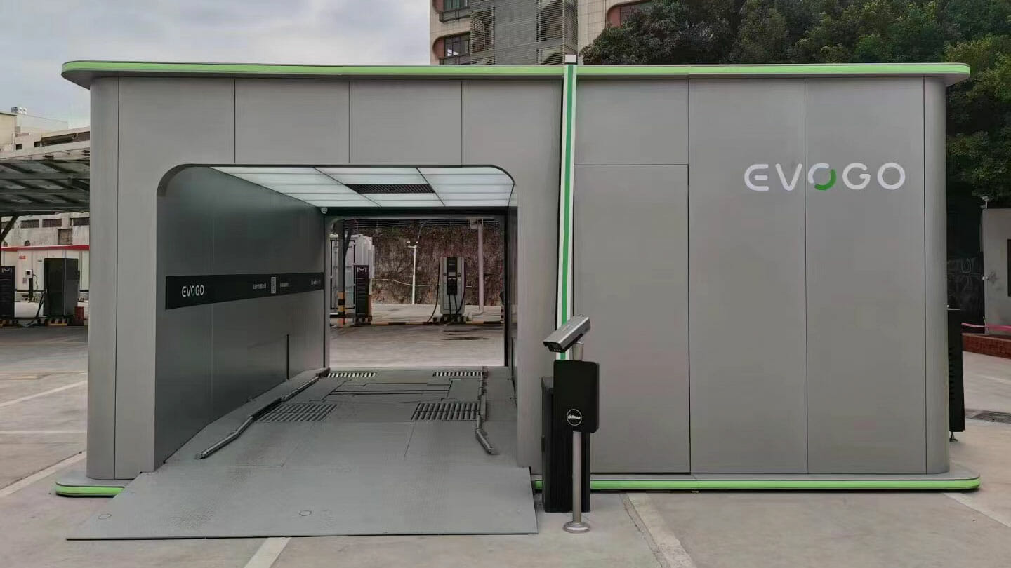

The battery swap stations, on the other hand, are highly compatible, offer need-based battery rental and are complementary to charging services, according to CATL. Taking a page out of NIO’s playbook, each EVOGO battery swap station takes up an area the size of about three standard parking spaces, can house up to 48 Choco-SEBs and allows one-minute swapping for a single battery block. These stations feature small floor space, rapid circulation, high capacity and can be customized to suit climates of different regions.
The dedicated App links customers with different modules of EVOGO, allowing the connection among customers, vehicles, stations and batteries, and provides other services as well.
